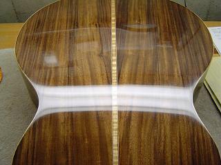

This guitar has a nitro finish and was done by hand. I show how to do this finish in my soon to be released finishing DVD.
After appropriate cure time, wet sand up to 1500 or even 2000 grit. The use Mcquires to rub to a high gloss.
Good luck

Robbie that doesn't look very good. Send it to me and I will make sure you don't have to look at it any more. Well since that isn't an option the video sounds great, when are you expecting it out?

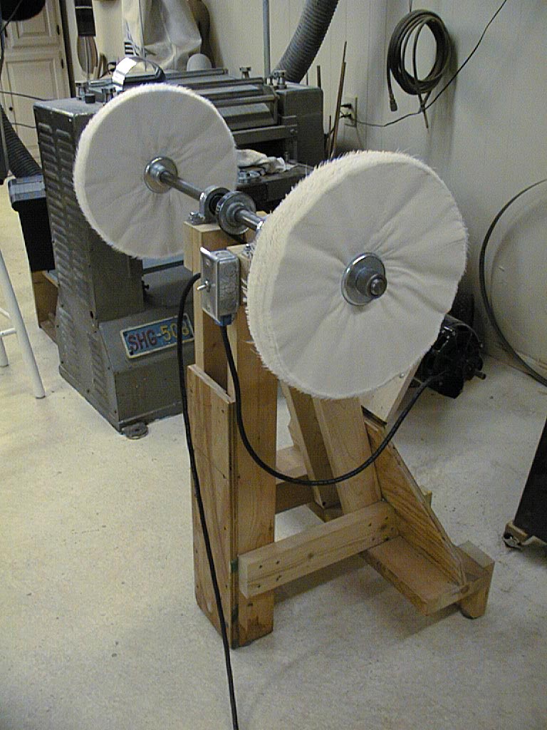

DVD might make a good Christmas present for my wife.      I also have to put a shop fox arbor and buffing wheels c/w menzerna compounds on wish list. "Heavy sigh" this building can get expensive can't it. Seems like I am always buying something to help fix up or save time. But I love building guitars. Have a good night.

if you are looking to buy an arbor you might want to look at the 1" arbor/
pillow block set sold by Klingspor for something like $89. If you have an
old motor and some scrap lumber you can put together something quite
serviceable for not a lot of money.
